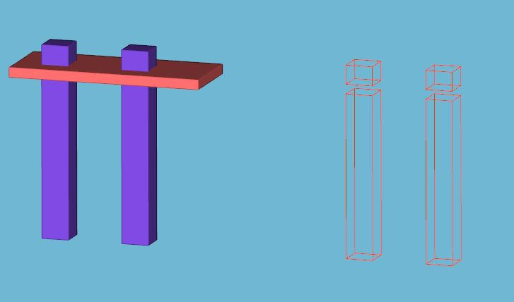

I have attached a pic.
The pic on the left is 2 posts with the cutting solid in position, The pic on the right is after the cutting function, but the 2 posts are still one entity, I cannot delete the unwanted part (s). An explode function you could "explode" the parts and delete the unwanted bits, -

There is a solution > Use the "Selective Cut, Keep Cutting Solid". Using the pic above as example > Select the command mentioned, Pick the cutting object (the flat piece) then select the part UNDER the flat piece, and the small unwanted bit disappears.
It´s true and in some cases, it can work, but i don´t recommend solving this situation with it, because it may give you problems. The point it´s the same as before, the file should be always as clean as possible to avoid crashes when not expected or situations when the file stops working properly.
