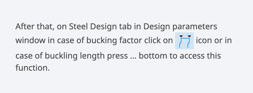

To solve this problem, Buckling length based on buckling shape, available in X8, helps to determine the buckling length/ buckling factor obtained from the result of Buckling analysis directly from the buckling shape.
3. Application of the method
To use this function, it is necessary to have result of the Buckling analysis (Buckling tab). It is recommended to choose load cases and load combinations, that are relevant for the design member to get the critical cases.
