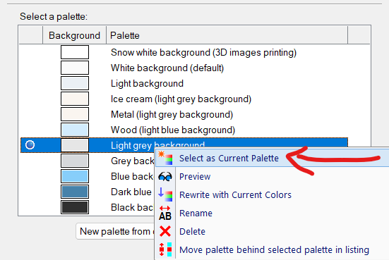

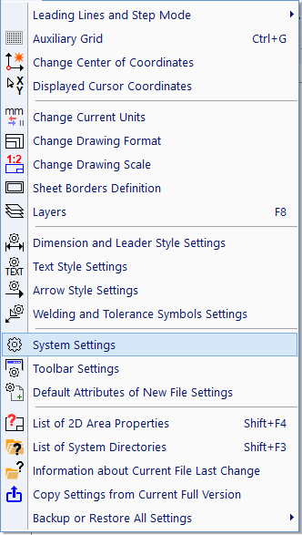

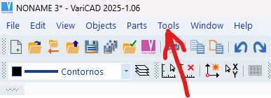

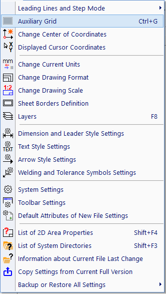

  • To change background color, Tools
    Inside the pop-menu... choose System Settings

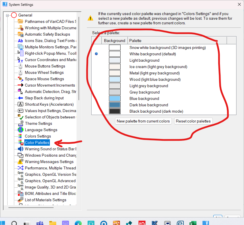

    It will open a big dialog box.
    On the left side, Color Palletes and after on the right side select what you want... pick Select as Current Pallete (see below).

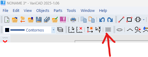

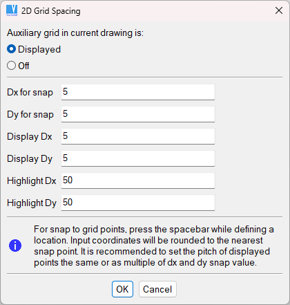

    Regarding the Grid, you can turn it On or Off. You have several ways. On the Ribbon you have an icon you can pick for that purpose.
    You can also go again to Tools  -> System Settings, or use a shortcut Ctrl + G. Everything the same...
    It will open a dialog box, like below...
    You can choose to have it On (Displayed) or Off.
    The options are only to see Dots, no Lines, but we can choose the spacing between dots (Display Dx or Dy) and a "blacker" dot defining the value within Highlight Dx or Dy.
    For the shown definitions the final appearance it´s like below.
    I hope it helps!

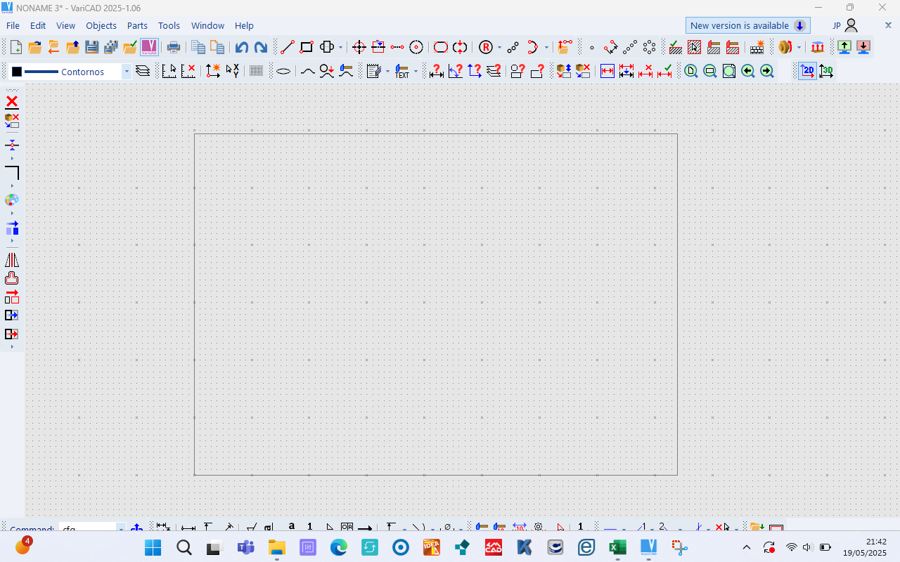

    I have adjusted the background color. :smile:

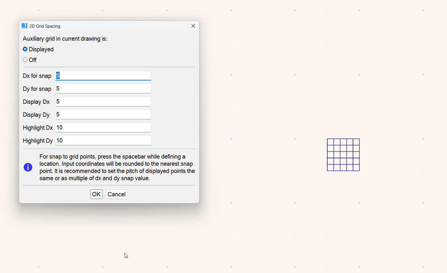

    With the grid, I am not so happy. But it seems, that's the best possible configuration.
    See screenshot attached.
    I've drawn 25 rectangles - each rectangle is 1x1.
    Thank you for your help.
