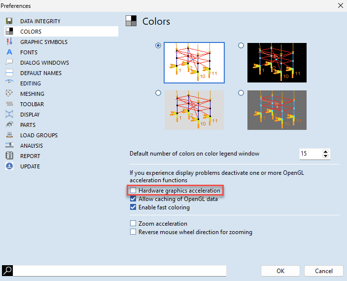

- If the issue persists, disable "Hardware graphics
acceleration" in the program settings by navigating to: Settings
/ Preferences / Colors and unchecking the “Hardware graphics
acceleration" option.
