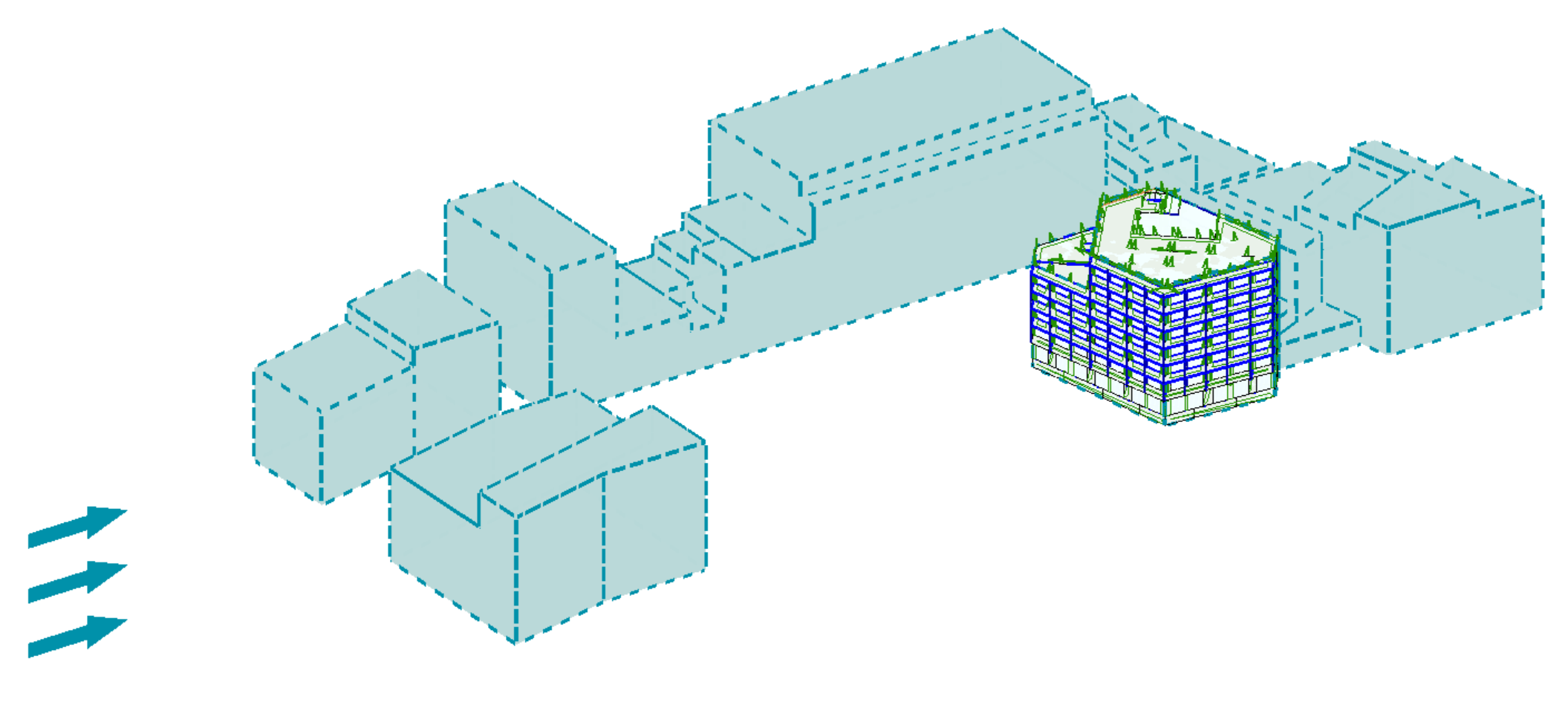

Another challenge was the user’s intention to consider the influence of the urban built environment on airflow and wind load. This is also made possible by the WIND module.
Environmental objects and adjacent buildings can be modeled as ‘Non load bearing’ load panels. This option ensures that the software does not assign loads to these panels.
Streamlines around the building and its surroundings:

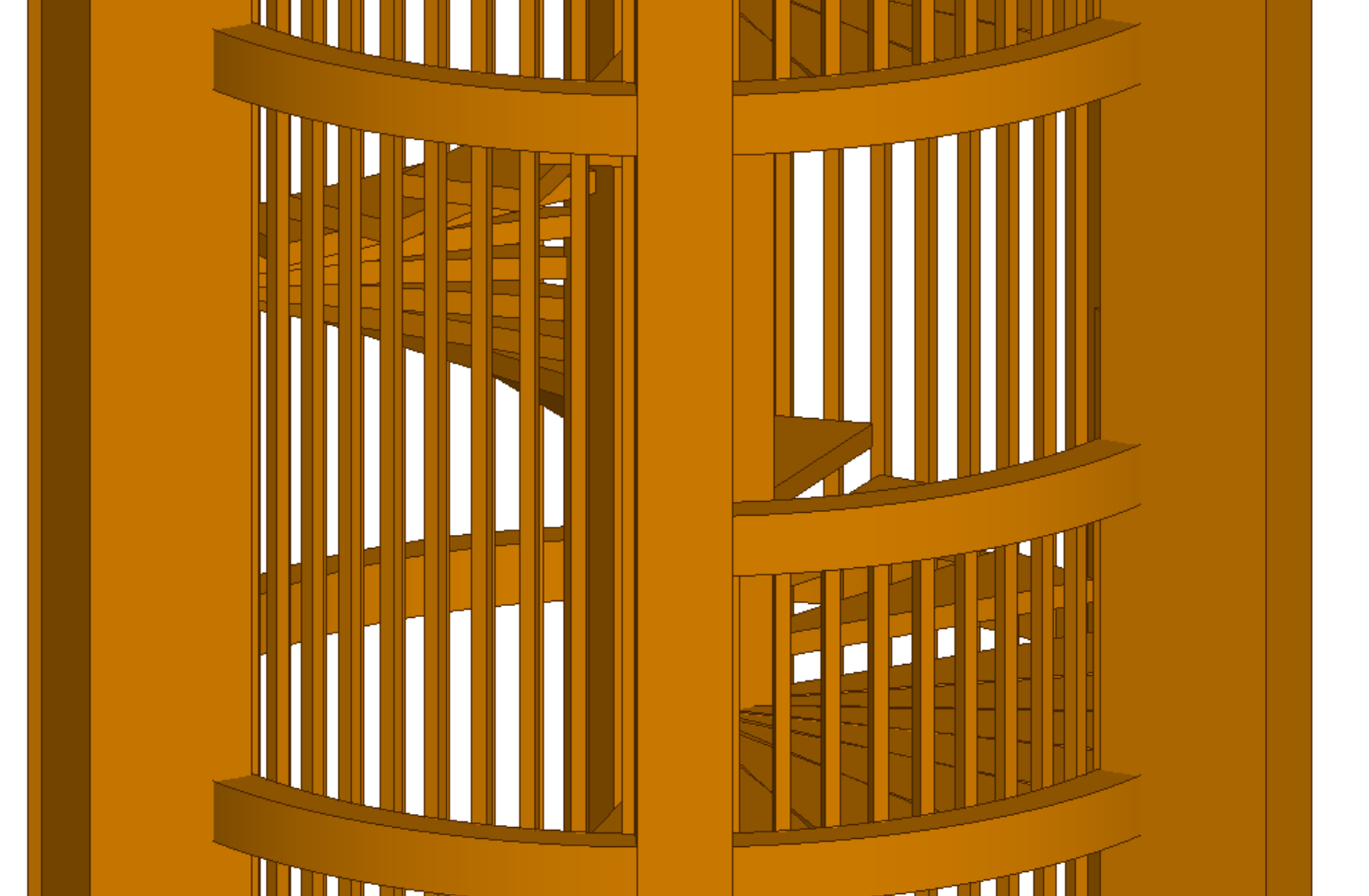

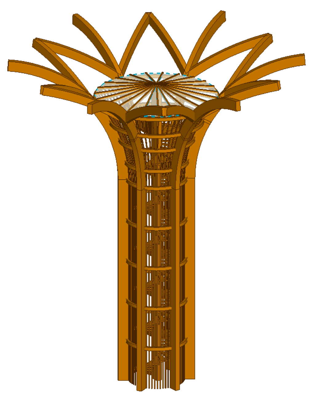

The 20-meter-tall lookout tower is topped with a spherical cap measuring 7 meters in diameter. Inside, a spiral staircase with a 4-meter diameter forms the main stair structure:
The difficulty of the task arises from the structure being only partially enclosed. A dense wooden cladding that weaves through the load-bearing structure protects the interior space from the wind. As a result, the airflow slows down significantly, thereby increasing the wind load on the structure.
Classical methods for determining wind load require significant approximations and conservative assumptions, often neglecting the permeability of the cladding.

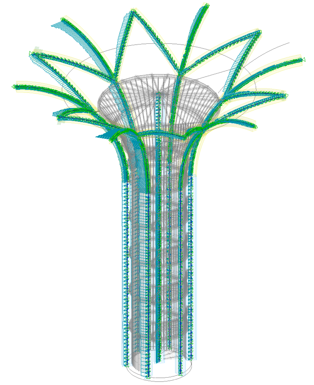

The software generates line loads on the rods by integrating the pressure field:
In the case of truss elements, the wind pressures acting on the members are represented by concentrated forces applied at the member endpoints.

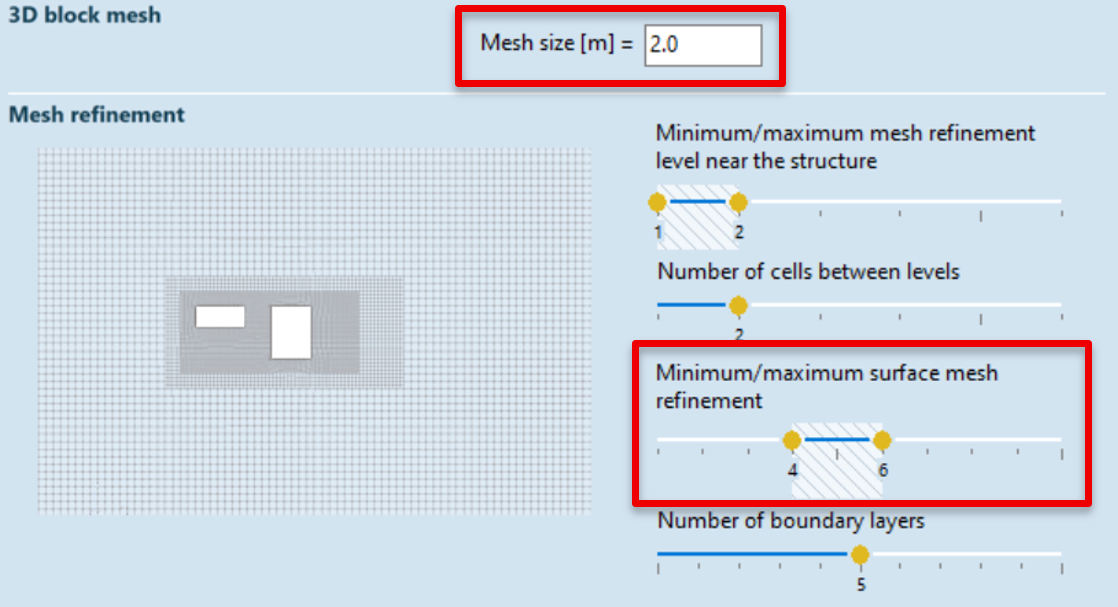

The meshing algorithm refines the block mesh size n times in the vicinity of the structure. This implies that the smallest thickness the meshing algorithm can still enclose is mesh size/2n. The value of n corresponds to the ‘Minimum/maximum surface mesh refinement’ setting. Therefore, if we want to mesh a 10 cm thick balcony slab with a block mesh size of 2 meters, n must be at least 5, since in that case m / 25 = 0.0625 m. If the refinement level is lower than this, the mesh will not represent the geometry adequately.
Elements that do not have a considerable impact on the wind load should be excluded from the simulation. For instance, a bracing cable with a small diameter generally has minimal impact on the wind load; however, accounting for it can considerably increase the complexity of the simulation.
First, analyze the structure using a coarse mesh, then perform the simulation with a refined, more accurate mesh.
